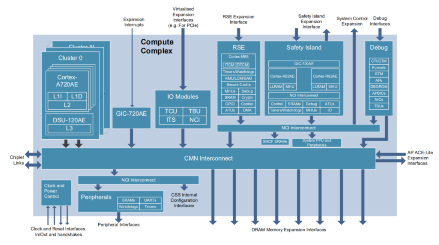

Components
Arm Zena CSS consists of the following main components:
System Block Diagram
Fig. 21 System Block Diagram

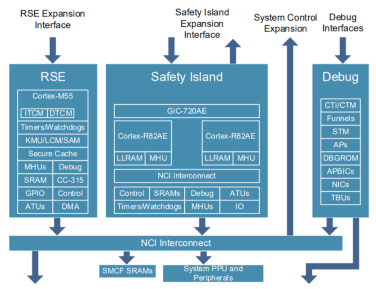

System Management Block
The System Management Block (SMB) consists of the RSE Block, the Safety Island Block and the System Management Domain, as well as expansion interfaces for system management functions including SCMI services.
Fig. 22 System Management Block
RSE
Runtime Security Engine (RSE) is based on Cortex-M55 core and is a security subsystem fulfilling the role of Root of Trust.
See RSE Cryptography for platform which does not use the reference Arm Cryptocell cryptographic accelerator.
RSE provides an isolated Secure environment to provide security services to applications/services running in the PE Secure and Non-secure physical address spaces (PAS).
In the current software stack, RSE offers:
  • Secure boot, further details of which can be found in the TF-M Secure boot documentation.
The following address range in the RSE memory map provides a window into system address space:
Table 6 RSE Address Window Regions
From
To
Region
0x6000_0000
0x6FFF_FFFF
ATU Non-secure data access
0x7000_0000
0x7FFF_FFFF
ATU Secure data access
Safety Island block
The Safety Island Block is a subsystem comprising of one or more Cortex-R82AE CPU clusters. The software running on the Safety Island uses the SCP-firmware framework and is responsible for power, clock and CMN control.
The number of clusters and cores depends on the chosen configuration. In the “cfg1” configuration, there is only one cluster with a single pair of dual lock-step cores. In the cfg2 configuration, there are two clusters: Cluster 0 with a pair of dual lock-step cores, and Cluster 1 with four SMP cores.
The Safety Island Block contains a GIC-720AE interrupt controller.

Primary Compute
The Primary Compute consists of four processor clusters to run a rich OS such as Linux. Each processor cluster includes four Cortex-A720AE cores and a DynamIQ Shared Unit (DSU-120AE).
The DSU-120AE with up to 32MB of L3 cache ensures core coherency, supports features such as snoop filtering, bus protection, Dual-Core Lock-Step (DCLS) and power management via Power Policy Units (PPUs). For more details, refer to DSU-120AE Technical Reference Manual.
The adjacent Interrupt Block contains a GIC-720AE interrupt controller.
