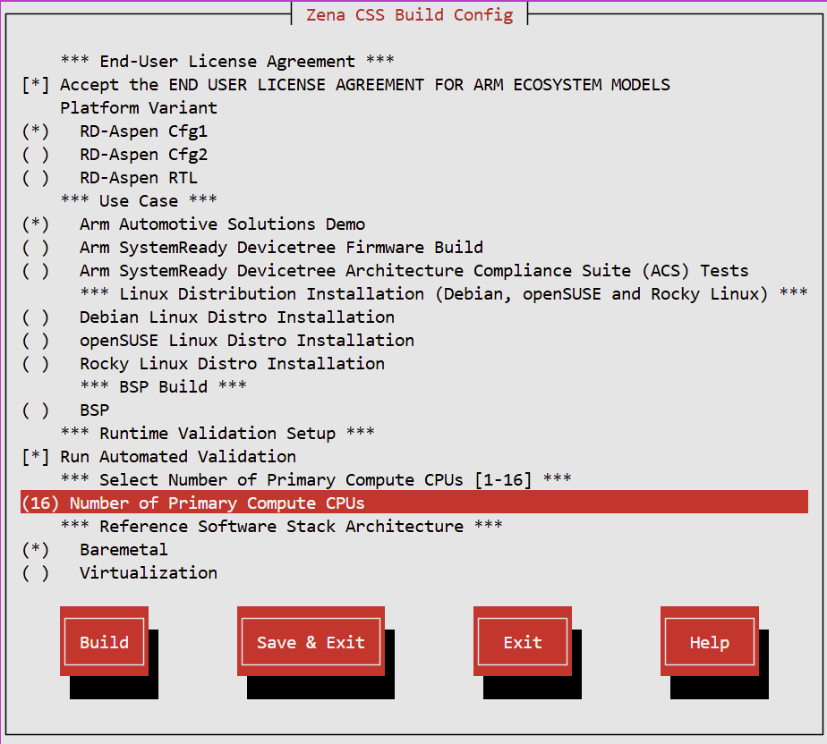

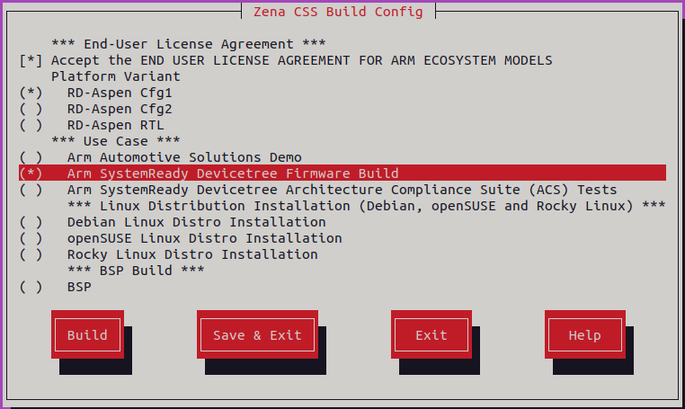

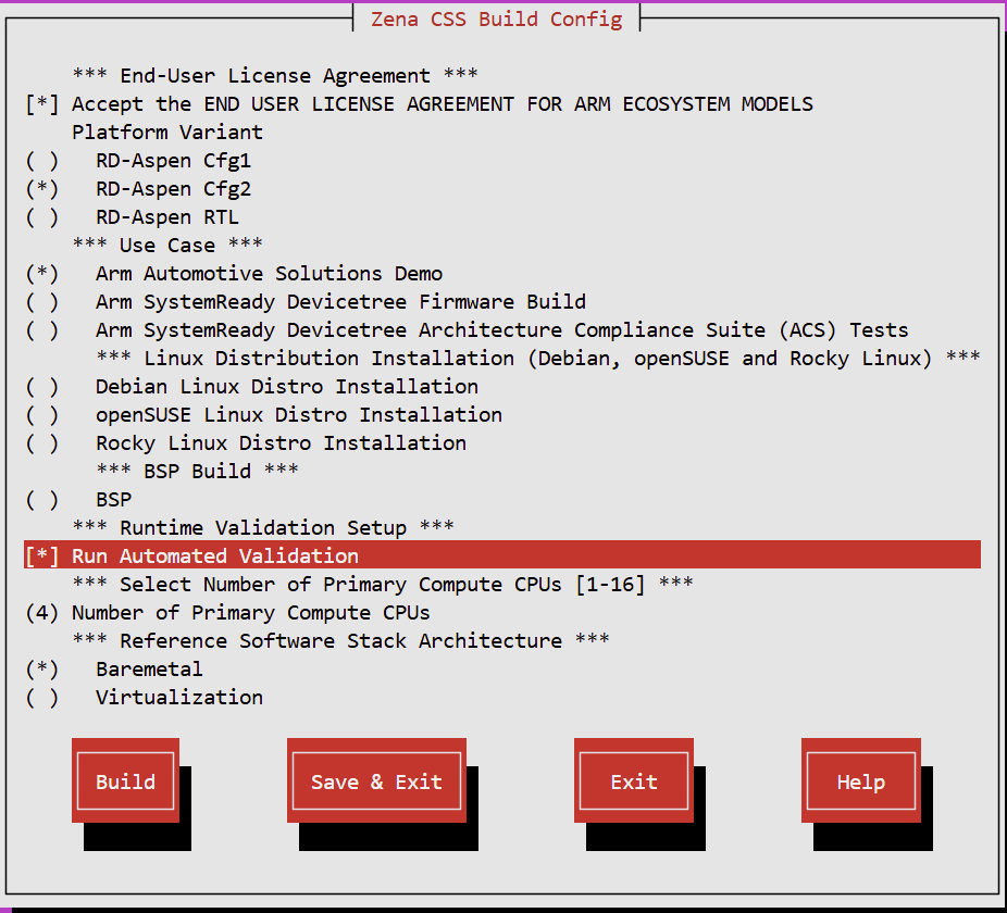

Run the following to open the configuration menu:
kas menu arm-zena-css/Kconfig
To build and run any image for an Arm FVP the user has to accept its EULA by selecting the corresponding configuration option in the build setup and pressing spacebar.
The default number of Primary Compute CPUs is 4. The user can change this by selecting a value between 1 and 16 from the Number of Primary Compute CPUs option. And also the default Platform variant is RD-Aspen CFG1. The user can change this to RD-Aspen CFG2 by selecting the Platform Variant option.
Arm Zena CSS Build Configuration Menu
Fig. 3 Arm Zena CSS Build Configuration Menu
To start the build, press the right arrow key, select the Build option and press enter. Subsequent builds with the same configuration can be started by running:

Build baremetal architecture

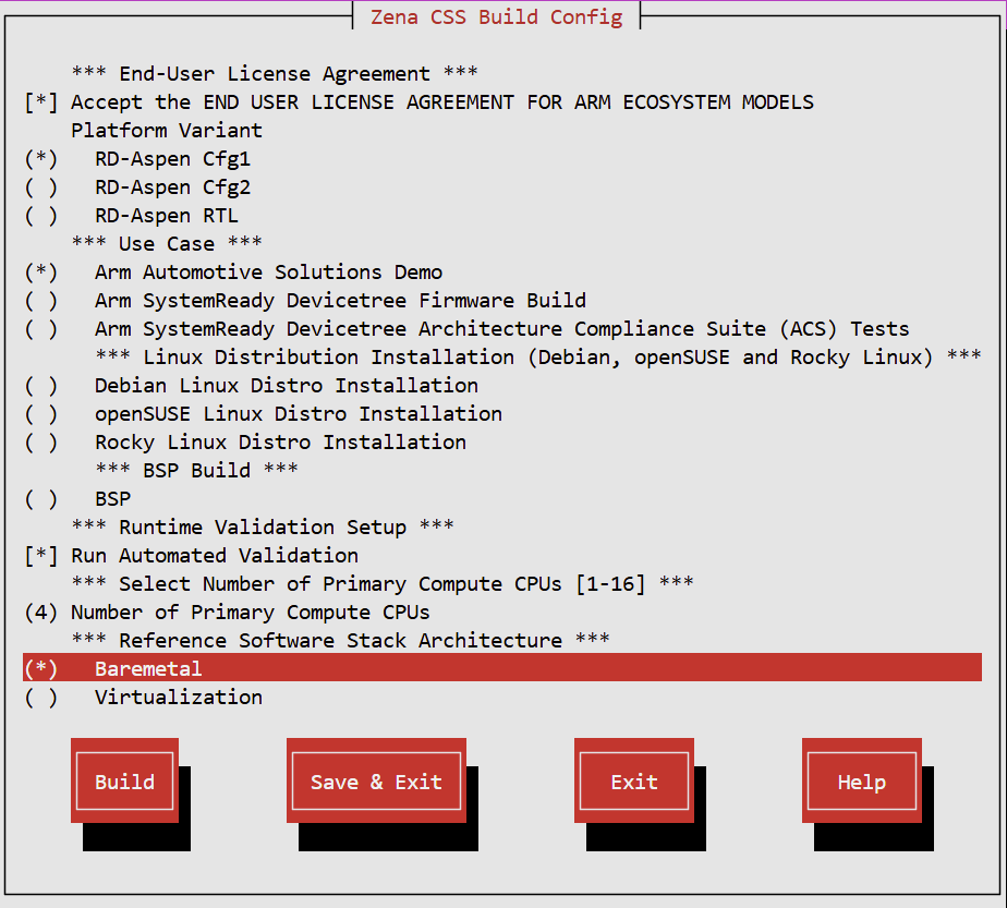

To run the configuration menu:
To build a Baremetal Architecture image:
  1. Select Use Case > Arm Automotive Solutions Demo.
  2. Select Reference Software Stack Architecture > Baremetal.
  3. Select Build.

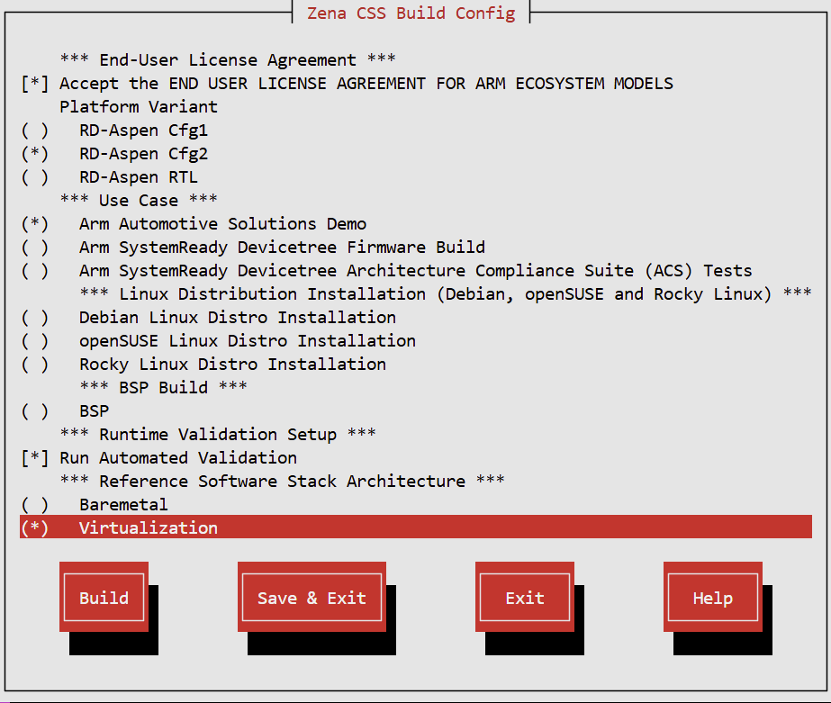

Build virtualization architecture
To build a Virtualization Architecture image:
  2. Select Reference Software Stack Architecture > Virtualization.
  3. Select Build.

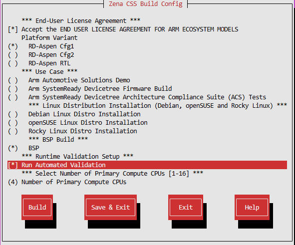

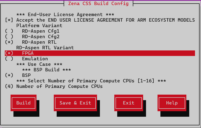

Build Board Support Package (BSP)
The BSP use case builds the minimal Arm Zena CSS Linux software stack required to boot the platform into Linux for bring-up and validation. It uses the nodistro configuration and generates the core-image-minimal image. It does not enable the Arm Automotive Solutions demo packages or virtualization-specific software.
Build
To build a BSP image:
  1. Select Use Case > BSP.
  2. Select Platform Variant as appropriate:
    • RD-Aspen CFG1, or
    • RD-Aspen CFG2.
    For RD-Aspen RTL, see Support for Arm Zena CSS Cfg0 RTL.
  3. Optionally adjust Number of Primary Compute CPUs.
  4. Select Build.

Run the configuration menu:
  1. Select Platform Variant > RD-Aspen CFG1 or RD-Aspen CFG2
  2. Select Use Case > Arm Automotive Solutions Demo.
  3. Select Build.
After the build process is complete, to start the FVP and run the software reference stack:
kas shell -c "../layers/meta-arm/scripts/runfvp -t tmux --verbose"

Build
  3. Select Build.
  3. Select Build.

Build
Run the following command to open the configuration menu:
Enable Mission-based power profile demo in Arm Automotive Solutions Demo
Fig. 4 Enable Mission-based power profile demo in Arm Automotive Solutions Demo
  1. Select Target Platform > RD-Aspen
  2. Select Platform Variant > RD-Aspen Cfg1 or RD-Aspen Cfg2
  3. Select Use Case > Arm Automotive Solutions Demo
  4. Select Reference Software Stack Architecture > Baremetal
  5. Set Number of Primary Compute CPUs to 16
  6. Select Build and press enter.
  3. Select Build.

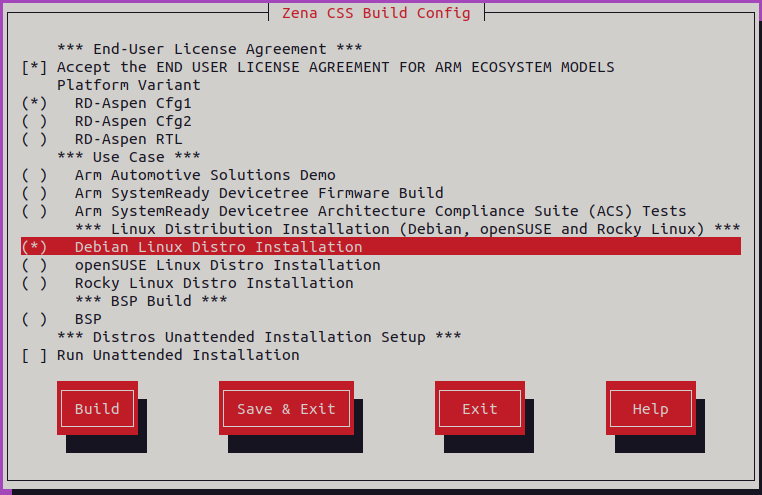

To build the Arm SystemReady Devicetree Linux distros installation tests:
  1. Select Debian Linux Distro Installation under Linux Distribution Installation (Debian, openSUSE and Rocky Linux) from the Use Case menu.
  2. Select Distros Unattended Installation Setup > Run Unattended Installation.
  3. Select Build.
Arm Zena CSS Build Configuration Menu - Debian Linux Distro Installation
Fig. 5 Arm Zena CSS Build Configuration Menu - Debian Linux Distro Installation

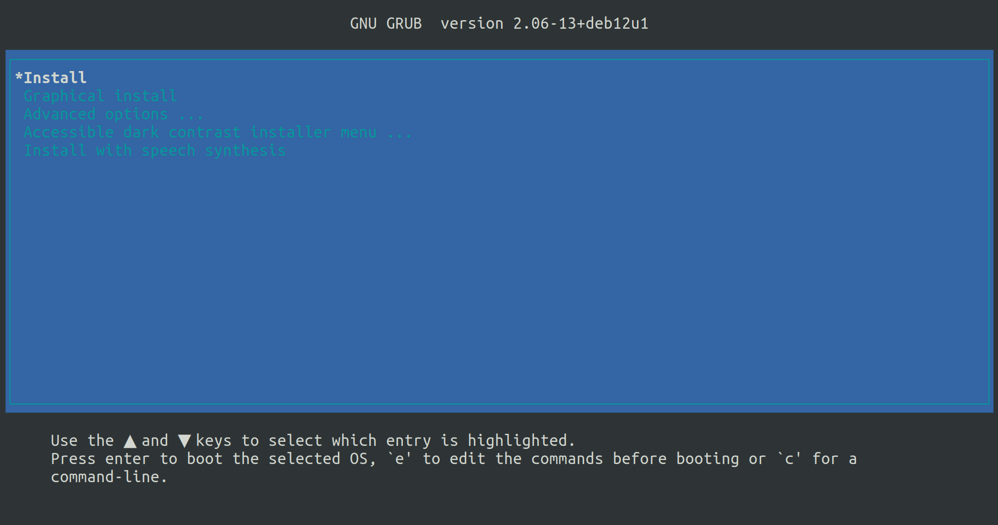

Distro installation
Run the following command to start the installation:
The whole process of installing Debian will probably take about 5 hours. The installation process begins when you see the following:
Grub Install Options Menu - Debian Linux Distro Installation
Fig. 7 Grub Install Options Menu - Debian Linux Distro Installation
Select Install to start the installation process. After selecting Install, a sequence of graphical installer windows is displayed, prompting for installation preferences. You may choose the appropriate options in these windows based on your requirements. For more information, refer to Debian GNU/Linux Installation Guide.

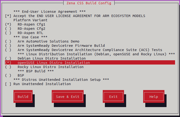

openSUSE
Distro unattended installation
In this test we have modified the installation ISO image to add the profile configuration file inside it. This required adding the profile.json file inside the ISO image to locate the profile configuration file during installation.
Distro installation
The firmware flash images need to be recreated with the following command:
kas shell -c "bitbake firmware-fvp-rd-aspen -C deploy"
  1. Select Use Case > Linux Distribution Installation (Debian, openSUSE and Rocky Linux) > openSUSE Linux Distro Installation.
  3. Select Build.
Arm Zena CSS Build Configuration Menu - openSUSE Linux Distro Installation
Fig. 8 Arm Zena CSS Build Configuration Menu - openSUSE Linux Distro Installation

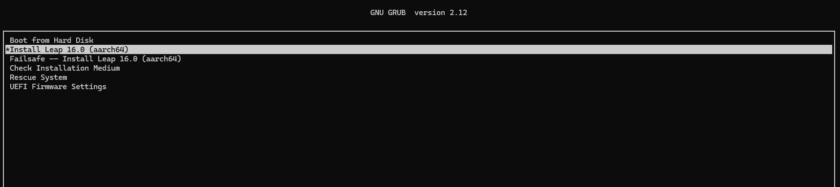

The whole process of installing openSUSE will take several hours. The install process begins when you see the following:
Agama Installer Options Menu - openSUSE Linux Distro Installation
Fig. 10 Agama Installer Options Menu - openSUSE Linux Distro Installation
Select Install Leap 16.0 (aarch64) to start the installation process.

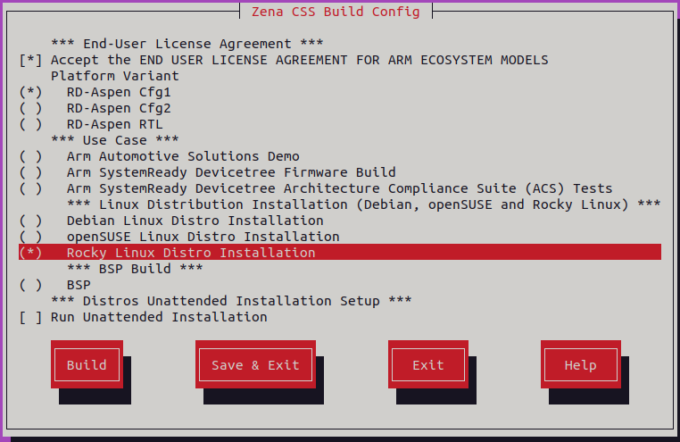

Rocky Linux

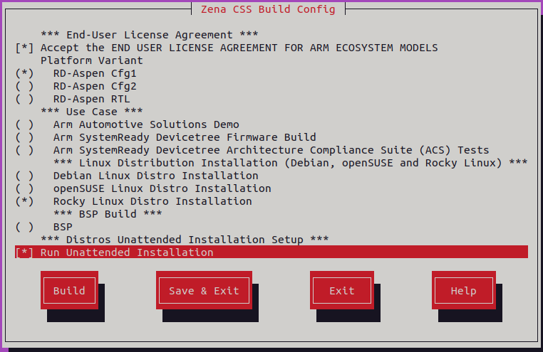

In this test we have modified the installation ISO image to add the kickstart configuration file ks.cfg inside it. This required editing the grub.cfg file inside the ISO image to locate the kickstart configuration file.
Distro installation
  1. Select Use Case > Linux Distribution Installation (Debian, openSUSE and Rocky Linux) > Rocky Linux Distro Installation.
  3. Select Build.
Arm Zena CSS Build Configuration Menu - Rocky Linux Distro Installation
Fig. 11 Arm Zena CSS Build Configuration Menu - Rocky Linux Distro Installation
This installation will take around 8 hours to complete. A similar output to the following shows when the installation is finished:

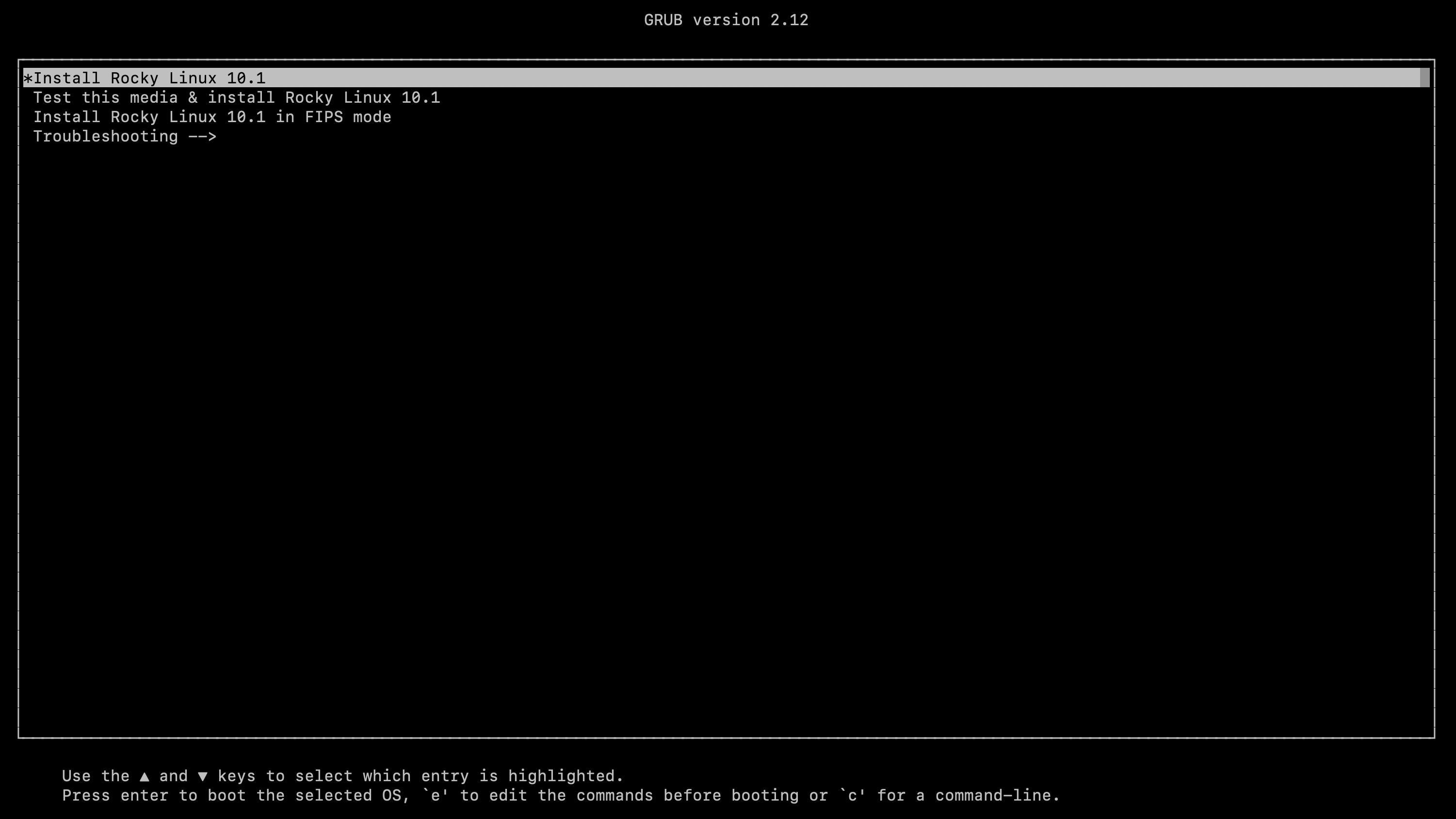

Grub Install Options Menu - Rocky Linux Distro Installation
Fig. 13 Grub Install Options Menu - Rocky Linux Distro Installation
Select Install Rocky Linux 10.1 to start the installation process.

    For 3) [!] Installation source, enter 3, then 1 to select CD/DVD.
    Installation source
    Choose an installation source type.
    1) CD/DVD
    2) local ISO file
    3) Network
    Please make a selection from the above ['c' to continue, 'h' to help, 'q' to
    quit, 'r' to refresh]: 1
    For 4) [!] Software selection, enter 4, then c to continue.
    For 5) [!] Installation Destination, enter 5, then c to select the default options.
    For 8) [!] Root password, follow the prompts to enter the password and confirm.
    After entering root password, 9) [ ] User creation becomes optional and can be skipped.
    The final configuration will appear as follows:
    Installation
    1) [x] Language settings                 2) [x] Time settings
           (English (United States))                (America/Chicago timezone)
    3) [x] Installation source               4) [x] Software selection
           (Local media)                            (Minimal Install)
    5) [x] Installation Destination          6) [x] Kdump
           (Automatic partitioning                  (Kdump is enabled)
           selected)
    7) [x] Network configuration             8) [x] Root password
           (Connected: eth0)                        (Root password is set)
           (No user will be created)
    Please make a selection from the above ['b' to begin installation, 'h' to help,
    'q' to quit, 'r' to refresh]:
    Now enter b to start the installation.

Arm Zena CSS Build Configuration Menu - Arm SystemReady Devicetree Firmware Build
Fig. 14 Arm Zena CSS Build Configuration Menu - Arm SystemReady Devicetree Firmware Build
Build
To build the Arm SystemReady Devicetree firmware image:
  1. Select Use Case > Arm SystemReady Devicetree Firmware Build.
  2. Select Build.
The firmware images listed below can be found in the directory build/tmp_systemready/deploy/images/fvp-rd-aspen/:
  • ap-flash-image.img
  • combined_provisioning_message.bin
  • rse-flash-image.img
  • rse-otp-image.img
  • rse-rom-image.img
Arm SystemReady Devicetree Architecture Compliance Suite (ACS) tests
The ACS for the Arm SystemReady Devicetree compliance is delivered through a live OS image, which enables the basic automation to run the tests.
The system boots with the ACS live OS image and the ACS tests run automatically after the system boots. See ACS tests for more details.
Note
For a full SR compliance report on the Reference Software Stack, the Debian, openSUSE, and Rocky unattended installation use cases must be run before the ACS tests. You should not delete or modify the build directory between the unattended installations and the ACS tests, otherwise the results for SR compliance will be inaccurate. If either unattended installation is run multiple times, only the results from the most recent installation will be considered. See ACS tests for more information.
Build and Run automated validation
To build and run the Arm SystemReady Devicetree ACS tests:
  1. Select Use Case > Arm SystemReady Devicetree Validation > Arm SystemReady Devicetree Architecture Compliance Suite (ACS) Tests.
  2. Select Build.
  1. Select Arm Automotive Solutions Demo from the Use-Case menu.
  2. Select Baremetal from the Reference Software Stack Architecture menu.
  3. Select RD-Aspen Cfg2 from the Platform Variant menu.
  4. Select Build.
Run the FVP
After the build is finished, run the following command to start the FVP and run the software reference stack:
Arm Zena CSS Run Automated Validation Menu
Fig. 15 Arm Zena CSS Run Automated Validation Menu
To start Automated Validation
  2. Select RD-Aspen CFG2
  3. Select Baremetal
  4. Select Run Automated Validation
  5. Select Build option and press enter.
Fig. 16 Arm Zena CSS Run Automated Validation Menu
  3. Select Virtualization

BSP Use Case
Fig. 17 Arm Zena CSS Run Automated Validation Menu
  1. Select BSP
  3. Select Run Automated Validation
  4. Select Build option and press enter.

Build
The capsule for testing will be generated together with the image for the software stack when building. The capsule-on-disk update is supported for both baremetal and virtualization architectures in the software stack.
  2. Select Baremetal from the Reference Software Stack Architecture menu. Choose the option from the Platform Variant as appropriate; either is supported.
  3. Select Build.
  1. Select Arm Automotive Solutions Demo from the Use-Case menu. menu. Choose the option from the Platform Variant as appropriate; either is supported.
  2. Select Virtualization from the Reference Software Stack Architecture menu.
  3. Select Build.
Fig. 18 Arm Zena CSS Build Configuration Menu

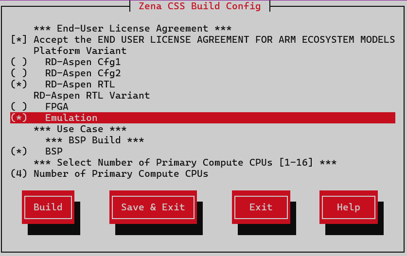

The Software Reference Stack enables builds for the Arm Zena CSS Cfg0 RTL.
Currently, the Board Support Package (BSP) use case is the only one available. It provides the minimal functionality required to boot into a Linux shell.
RTL variants supported are ‘Emulation’ and ‘FPGA’.
Note
RTL builds are intended for execution on real hardware. Do not attempt to run RTL builds on FVP. RTL variants are supported for ARM’s internal hardware options - ‘Emulation’ and ‘FPGA’. Please contact Arm for more information regarding RTL platforms.
Build
  1. Select Platform Variant > RD-Aspen RTL
  2. Select RD-Aspen RTL Variant > Emulation or FPGA
  3. Select Build.
Arm Auto Solutions Build Configuration Menu - RTL FPGA Build
Fig. 19 Arm Auto Solutions Build Configuration Menu - RTL FPGA Build
Arm Auto Solutions Build Configuration Menu - RTL Emulation Build
Fig. 20 Arm Auto Solutions Build Configuration Menu - RTL Emulation Build
